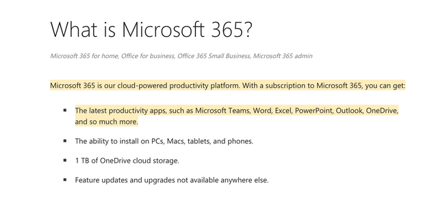

I understand an aversion to cloud-based and wanting a more tangible backup. But as 365 is a cloud-based platform it seems the cloud is already being used.

I have no idea as Outlook 365 is downloaded onto my laptop and I can access it even when not connected to the Internet. I have no idea how to access Cloud and have no interest in accessing it anyway preferring something tangible. Basically being very old fashion, I don't trust anything external like Cloud. I have no idea if it can be hacked or not, but why take the chance.
Besides if we have a power failure and lose the Internet I cannot access Cloud and anything stored in it, but I can if it is store on my laptop.

See.

Still have no idea what it means, but I still want my stuff on my laptop and backed up on my USB stick.
