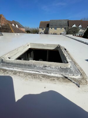

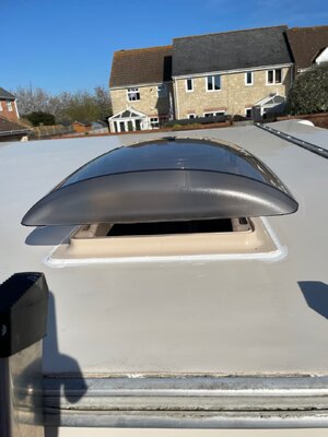

The new domes alone are as rare as rocking horse stuff, but they are out there. I was offered one back in March, not new , used , but allegedly in good Nick. That wasn’t the real issue.
Whilst the dome was cracked, when I got up on the roof the entire sky light assembly plastic was disintegrating before my eyes.
See the photos. It needed an entire new assembly which for my size 280 x 280 wasn’t too expensive. Circa £65 on E bay.IMG_1140.jpegIMG_1132.jpeg The removal and fitting took me a leisurely day. Cleaning up took ages and of course the Soudal RV 61 sealant was £16 ish.
