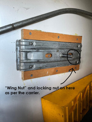

Currently I've borrowed the "wing nut" that is part of the carrier and that, together with the short flat section of the carrier firmly bolted to a length of wood which in turn is both glued and screwed onto the front bulkhead, provides a safe and firm home for the wheel.
