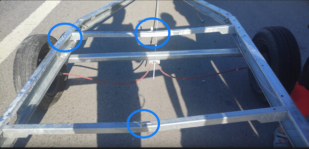

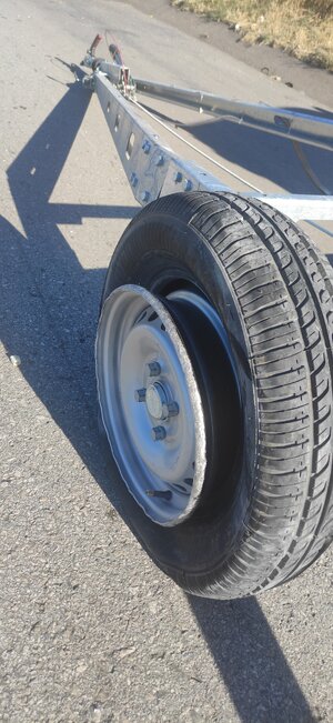

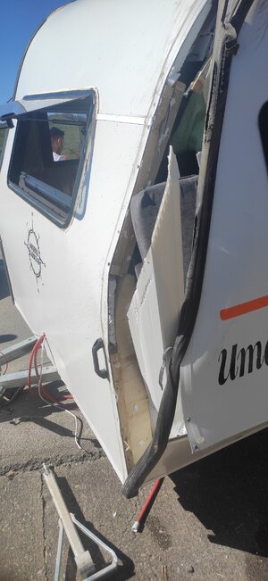

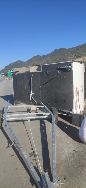

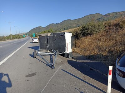

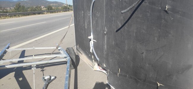

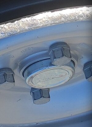

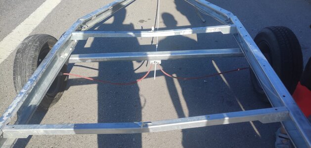

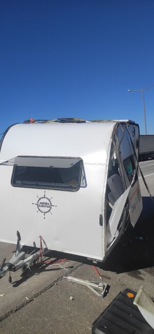

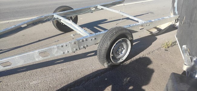

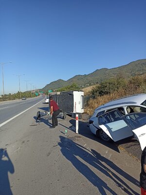

Hello everyone. I had an accident with the caravan in Turkey. I think first the tire of the caravan burst. The caravan overturned, I hit my vehicle on the side of the road and the caravan overturned. But it didn't seem normal to me that the caravan was tipped over. As you can see in the photos, the caravan is connected to the chassis with a few screws. The manufacturer says that the connections are made correctly. Technically, I need your help. Is it normal for this caravan to fall apart from the chassis like this? Thanks in advance.

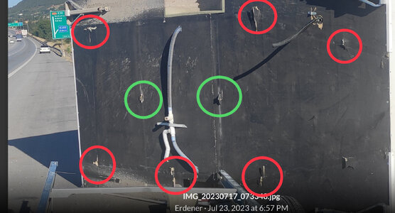

It is "correct" that floors of caravans are typically held by a number of through bolts to the chassis.
Your van has been subjected to a violent "throwing about".
It is not unreasonable, that the forces that must have been involved, acting on these bolts could be sufficient to pull them through the floor.
It is not a situation that van makers would be designing their products to survive.
IMO it is way beyond being commercially economic to repair.

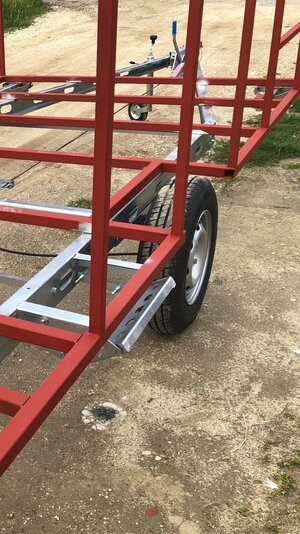

Sorry to hear of the accident. I can see the bolt attachment points on the chassis, and the positions where the through bolts pulled out of the body of the caravan floor. The tyre failure must have led to a violent force on the caravan to have detached the body from the chassis. My own experience with floor bolts tells me that a British van may have exhibited a similar failure in the circumstances of your accident.

To answer the specific question you asked, No its not normal for caravans to separate from their chassis. And whilst continuing to drive with a deflated tyre can lead to damage of the wheel arch and body work close to the wheel, I have never seen or heard of a caravan body separating from its chassis in the way yous has in the pictures. If it has happened previously it must be very very rare.
This begs the question why has yours managed to separate?
Looking at the images there is evidence of at least 14 points on the underside of the floor that have evidence of something breaking out through the floor, these correspond with fixing points on the chassis. And in addition the two chassis cross members are clearly deformed in the centre where the fixing have been forced upwards. The chassis is also quite distorted.
The damage to the wheel rim is consistent with the tyre loosing its inflation and continuing to be driven for some distance. but I could not see any tyre fabric separation so it has not been flailing the wheel arch or body work.
I note the caravan is a Angora Caravan, which is apparently manufactured in Turkey. I am not intimately familiar with the brand or its construction methods or quality, but based on the evidence of the fixing points in your picture, I don't think there is any inherent design failure concerning the security of the body to chassis fixing.
This isn't very helpful, but it seems to me something more severe than just a tyre deflation has contributed to the damaged on show.

As an observation - it's a poorly designed chassis with little torsional stiffness - unlike an Alko chassis, the axle tube doesn't act as a stiffener so the two "wishbones" would be able to flex significantly - from those photos I'd suggest that the caravan body was stronger than the chassis!

IMO the pictures do not clearly show what actually occurred in the accident.
Some of the pictures show clearly that an accident has taken place with the bodywork still sitting on the chassis.
Other pictures show the bodywork completely separate from the chassis and on its side.
......so what force removed the bodywork from the chassis?

If you look at the first picture and expand it, you can see a lifting strop around the caravan, suggesting the on chassis pictures were taken during the recovery.

It's a difficult one, as presumably you were going uphill and with a wide a smooth hard shoulder, a tyre deflation would not normally be expected to throw an outfit around that much. Going downhill could be a different matter. Anyway good luck and I am glad that there were no personal injuries.

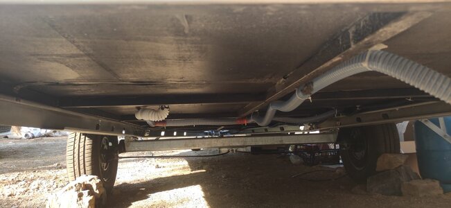

I apologize again for not being able to respond to your individual comments. I couldn't upload some photos due to internet problem. I also share these photos so that the connection points on the chassis can be better understood. I am also attaching photos I took from other brands. I think that the connection should not be made directly with the chassis to the body, but the profile attached to the body should be connected to the chassis. But I don't know the technical stuff and frankly I'm confused. Thank you for your interest and comments.

Your most recent pictures do not show any better details of the detachment.

Some things appear to me from the pictures.
It would appear that the fixing bolts have pulled through the floor. Understandable due to the soft sandwich construction. But I can only see 4 places on one side and just 3 on the other, plus two on the cross members. Though there are plenty of fixing holes.
Also.
If the bolt, nut and washer, had pulled through the floor. Why are they missing from the chassis? There just appear to be small-headed bolts on the cross members and a little something on one rail.
