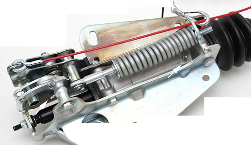

Congratulations on actually finding the hitch shaft's single grease nipple if it is the same as mine. IMO that's quite a challenge in itself.
( Edit; found an image if others need it)
I use Castrol LM, have been doing so for decades. Thinking aloud, the only real area of concern I suspect is that as the bearings are a "plastic", some grease matrix bases, might cause swelling. Seems from my experience LM does not to any level of concern, this van I have serviced for 16 years.Photo Merged[4994].jpg
