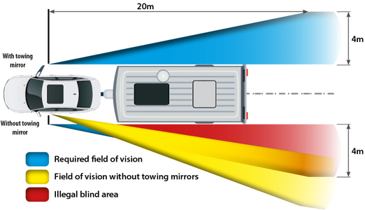

As I recall, when an outfit is aligned, the driver should be able to see the whole side extent of both sides of the vehicle (and trailer) and the bifurcated area behind the outfit to an additional width of 4m wide at 20m distance rearward from the driver.
To achieve this the mirrors must extend beyond the width of the vehicle and trailer. Not even a camera can see round corners.

This is image I meant to post showing the U.K. Legal requirements

They have to meet C&U regulation in UK it doesn’t specifically rule on specific vision devices. It’s more a set of principles. So it’s up to the car makers to design them to meet the regulations.
