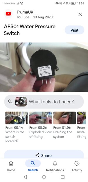

HI i have a bailey phoenix 640 the truma smartswitch broke the one shaped like a plug now obsolete truma have a 2nd generation to replace but wondering if the whale with pressure switch would be better and whst the connectiond eould be as old one 3 wires new one 2wires

Karlrob Do you mean the old Truma smart pressure switch like the one in the attached photo
