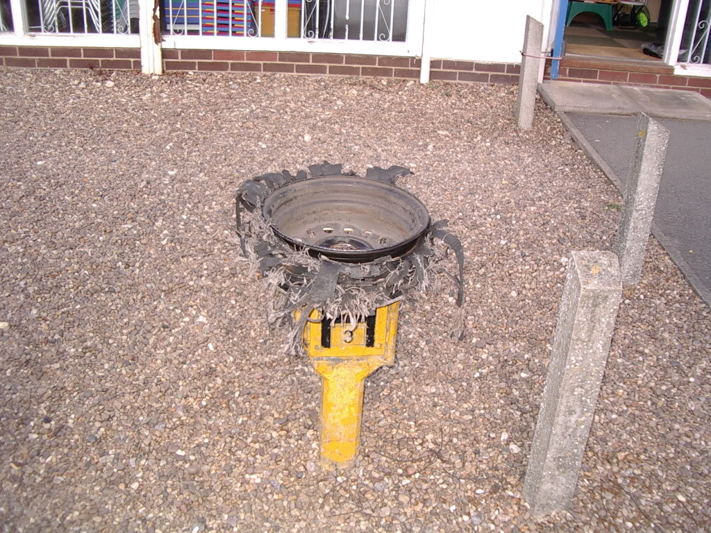

Having just experienced a tyre blow out, literally around the corner from home....how lucky was that....or unlucky...I’m keen to know more about tyre protection. I’ve now had both tyres replaced as I didn’t trust the other one.
Are there any preventative measures that I can take? Thanks all.

You did the right thing changing the other tyre as that is the recommended approach. Having good tread and tyres at correct pressure helps. Changing tyres at 5-6 years old. Also you could fit a TPMS like Tyrepal which gives warning of some deflating/overheat conditions. Some install tyron bands which are claimed to prevent a deflated tyre coming off of the rim, but I've not seen anything to show their actual functionality on caravans.

I clipped a curb in Natters just off the Innsbruck - Brenner autobahn avoiding a car coming round a corner in the middle of a very narrow road in the village. I blew out the right hand tyre on the caravan. The Tyron band allowed me to drive through the village until i found a suitable place outside the village where I could pull off and change the wheel. This is the second time Tyron bands have come to the rescue. The first was in Sheffield in 1993 when I did the same although that time it was entirely my own stupidity. However, again the Tyron band allowed me to drive on until I found a place to change the wheel. Therefore, for me, Tyron bands work.

When I had a tyre let go at 60 mph on the Monmouth-Newport dual carriageway there was the sound akin to being buzzed by a Tornado, a twitch from the caravan and then the rumble as the tyre continued to disintegrate. It was in my early days of caravanning and I checked the tyres tread and pressure but wasn’t aware of the age limitations.

A few years years back now, van had Tyron bands on, unaware I had blowout, thought Freelander had lost power. Unaware of blowout until stopped outfit to investigate loss of power, found the tyre shredded so I suppose Tyron band had done it's job and kept tyre on rim, however the rim was wrecked and also the wheel arch. Had them removed after that as I thought I would rather know earlier of the problem.
