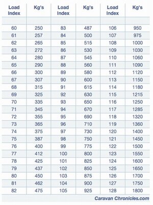

IMO it's much better to use Load Index and ignore the C

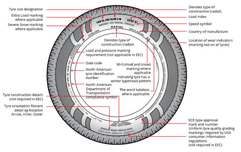

  • Size: Check your current sidewall for the exact size (usually marked with 'C' for commercial, e.g., 185 R14C or 175/65 R14C).

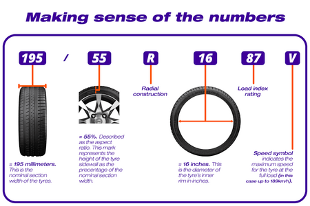

I would have just simply measured the wall height in mm , divide by width 174 and multiply by 100. You don't need to be overly accurate
In Sam's case I expect that it will come out about 80 to 85 %. What I would call a "normal ", 82% aspect tyre.

The difference between 80 an 70 % profile on a 175 tyre is about 18mm.
