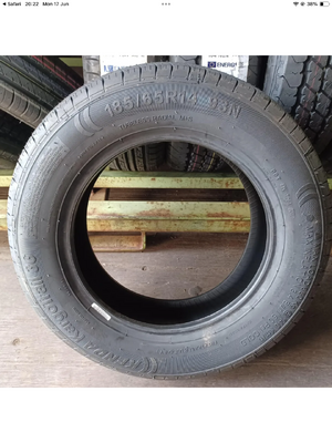

I’ve post several times over the years wrt specific trailer tyres. Once I was even told there is no such thing they are just higher load index. In UK the tyres you mention will have FRT Free Rolling Tyre (trailer use only)with the limitations as per your post. On caravans I have had GT Radial Kargomax ST6000, and on a small pop top the Kenda equivalent. The picture below clearly shows FRT etc embossed on the sidewall.
I fitted them as I wanted toughness, and the last word in aquaplaning resistance or cornering wasn’t top of my priority. I have nonetheless seen some online tyre retailers offering GTRadial ST 6000 without caveating their usage limits.
PS this is not a C tyre but just presented to demonstrate the FRT embossing. But GT Radial ST 6000 are C rated with 80% aspect ratio.
