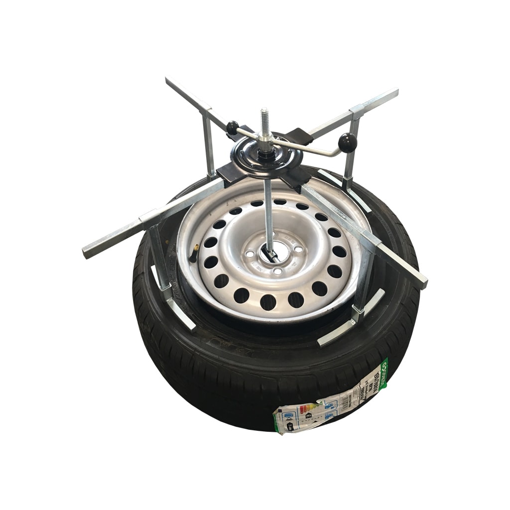

We had Tyrons on our first van. All well and good until you need a new tyre, then you have to go with Kwik Fit or find another fitter that will deal with them which at that time was not at all easy.
12,039
4,208
I have Tyron bands on my van, but will be removing them when I change the tyres this year as I have the Tyre pal, tmps fitted.
Not all tyre fitters have the kit to be able to remove the Tyron Bands when you change the tyres, I took over two years to get the portable kit which you would need if the tyre requires replacing.
Kwik fit only have the kits in a few sites.
The kits have been unavailable for years.

So will mine, but the reason is the inability of nearly every operative I have used to reinstall them correctly, "balanced".
It's far from a matter of fitting them but the need to fit them correctly, a tedious time consuming task.
I have had to redo it myself, but now I no longer have access to the kit or will-power to do so. Plus, those who know about fitting them gets thinner on the ground, finding anyone to do it is becoming a struggle. So the time has come, they are not going back.
