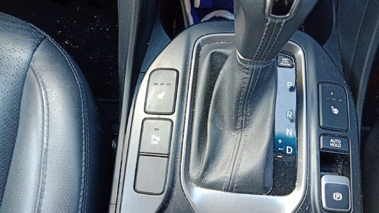

On my car , the rear parking sensor switch is the one on the bottom left.
