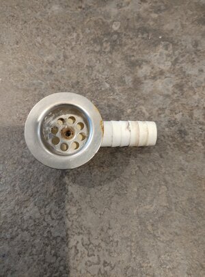

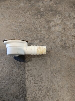

Hi I need to replace my sink plug and waste pipe has broken
My caravan is a Crystal moorea
The issue I gave is when googling it does not tell you the sink metal holder aperture size
Are these an industry standard bearing in mind mine is a Flemish van
The cut out looks like 30 mm
Thanks

I think from your pictures and description you actually have 1 1/4 inch or 28mm which is common. Looking online some seem to have a short smooth ‘spout’ and one I looked at said no plug supplied so read the small print!
