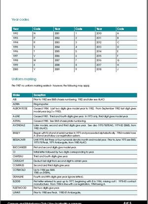

Sorry, that would help yes. I know it's pre 2010 and I'm guessing 2003 . I got stung a little on buying this. Guy have us the rum around, by the time we got to him I was checking for damp and structural, forgot electrics.
Sep 23, 2023
1,425
626
2,435
On image "year of codes" it is the 10th digit that shows the age on mine it's N,hence 1992,the codes can be found on the windows they start with S10_022955.JPG11_023013.JPG12_023028.JPG
