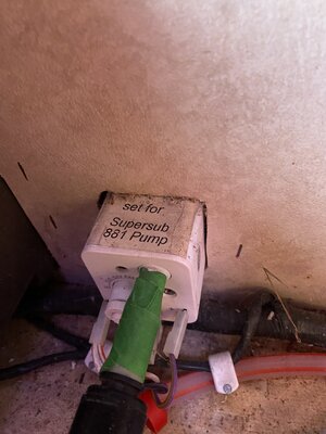

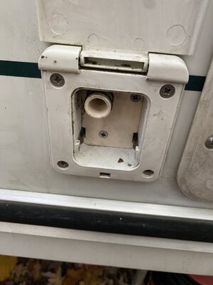

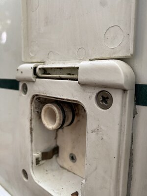

Just piggy backing into this thread. I’ve just done the same as SwindonCaravan. I have a 1996 Swift 380 Rapide. I have a whale 881 submersible pump (which works when clamped direct to the battery) but I can’t get water into the van - I’m struggling to find a connector for the hose. Any ideas what I need…?
I’d be very grateful for some help…

https://www.ebay.co.uk/itm/274895805659?
Is this what you are looking for or the block on the pump pipe that plugs in. If it is the block you are looking for you will have to buy the block pipe and pump as a complete unit
Thank you 🙏.
I guess I may need to replace that part, but is there something I should have on the end of my pump to connect to the water inlet?
I’m also only getting around 0.3v at the blade connectors in the van wall socket.
I would try cleaning the two electrical contacts in the water housing, they look worse for wear, check the wiring at the back of that housing, if your not up to speed with electrics, then final hope is a local caravan technician.

Thanks I will give those a try. My caravan came from Hampshire (not a gliding club) but I’d literally just bought it with no idea about caravans! My son is going to use it one a site for work for 3-months.
On your pump should be a pipe and a block that is on the pipe which connects into the side of the caravan. Theses are not separate items. But I think you will find that the 811 is now obsolete. This will mean to use water you would need to purchase a new type inlet to fit to side of caravan plus a new pump complete with connection to match the new type of inlet.
