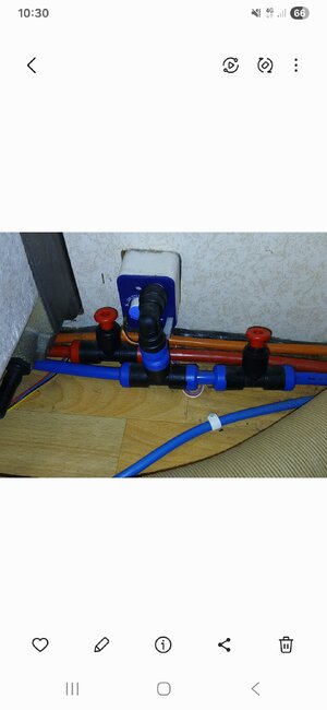

Hi, I'm new to caravans, I've just bought a 2003 caravan and I have connected the water and pump and it's bringing water in, however the water is being drained straight out. I understand there should be a valve to stop this and it's usually yellow, however I cannot see one and I've looked everywhere. I have attached a picture of where the water comes in and I think the connection on the right with the red plastic bung sticking up may be a valve as that side of the pipe is where the water comes out under the caravan further down the pipe. However the red bung is not easy to press down, if it is the valve at all. Can anyone clarify? I'll probably have to use a hammer to push it down so i want to make sure first? Or is there a nack to pressing them down?

I’d try a small amount of silicon spray on the drain valve/bung and let it soak for a while. Reduces risk of damage by just using a hammer.

That’s a carver water heater, the drain valve/bung is on the outside bottom left of the water heater.

It doesn’t look like there is a water pipe attached to the water inlet on the water heater, the black spout on the water heater to the left of the red bung

The Red bung in the T is a blanking plug. Caravans of that age usually had one of those Red bungs underneath the caravan to drain. Push the outer ring around the Red bung inwards to release then you will be able to pull the bung out to drain water.

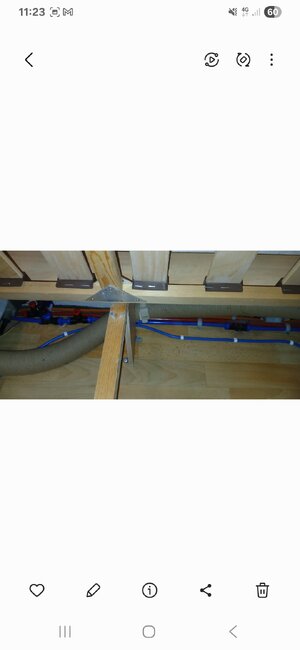

I've found that now. That's screwed in. I have attached another photo of the whole pipe, the black connector to the right of the photo on the blue pipe is where there is an outlet where the water is draining under the caravan. So that's why I thought it was something to do eith the connector with the red bung top as it's on the same pipe. I've tried hammering that in but its not moving.

Just a thought, have you tried pressing down inside of the red "button" and then pushing down the red part, I don't think hitting it with a hammer is a wise idea.
So, the one to the right of the wooden upright?
If it is, is that a T piece with a pipe/connector coming down through the floor?
If it is, then you might find the red blanking bung is not in it and needs one fitting

........the red blanking plugs in your first picture are nothing to do with your problem.
Caravans of 2003 era like yours had a similar red plug fitted under the caravan to facilitate draining the system.
Your caravan likely has a red blanking plug missing from the fitment that is issuing water under the caravan. Did the previous owner leave a red blanking plug loose somewhere in the caravan?
If not you need a John Guest blanking plug.

I know you have already received quite a number of replies with advice, so I hadn't taken a close interest in the thread but I knew there was something niggling me it until it hit me a few moments ago.
The pipework demonstrated in your pictures does not look like the standard of work most caravan manufacturers would achieve, it looked too neat! and the fittings did not look like typical items for the time.
You tell us the caravan is a 2003 model, but your picture shows the side of a Cascade 2 water heater. That does not make sense because the Cascade 2 water heater was taken out of production in 2000.
Carver sold its leisure product range to Truma in 1999, and Truma then closed down the Carver heater production, replacing them with Truma models in 2000 early 2001. It's unlikely any of the main caravan manufacturers would have designed any 2003 model caravan to accommodate a Cascade 2, they would almost certainly have designed it for the Trumastore equivalent, which is an entirely different shape and design.
This means either you have not got a 2003 model caravan it could be earlier, or that a previous owner installed an old stock Carver Cascade 2 in your caravan, which seems to be the more likely scenario.
This doesn't help with your immediate problem , but it might explain why we have not been able to give an instant solution. What I can state is that you should definitely not require a hammer to make the system operate properly, there should be a less destructive method of safe operation for draining for storage and resealing for usage.
