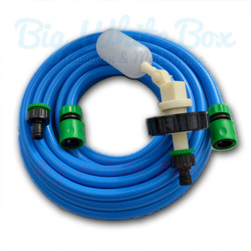

This is what in my aquaroll

If that is exactly what you have, then you do not have a submersible pump.🤔 You have an onboard diaphragm pump, which are great pumps but are noisy, and because it's onboard and fixed to the caravan, the caravans body amplifies the noise. Sorry but it's normal for your installation.🙄

Cheers, least i now know there is nothing wrong with it, thanks 👍
If it is a Flojet pump they are quite noisy but can be quietened. Firstly they have rubber feet but the caravan maker often screws them hard into an upright surface. This effectively creates a noise short. Ideally there should be no mechanical fixing direct from pump to surface. But eh oh it’s a caravan not a submarine. Re position the pump to sit on a flat surface and the screw fixings don’t have to be so tight as when it’s vertical so the rubber supports more of the load. Also make sure pipework near to the pump doesn’t touch fixed surfaces as that too acts as a sounding board. A small bit of pipe insulation foam works well. Lastly near the outlet of the pump there is normally an cream cylinder like item that is vertically mounted. This is a simple accumulator to even out pump discharge pressure. That can resonate against its supports and create noise. Best way is run the pump and jiggle the accumulator to see if it gets quieter. Then a piece of pipe insulation foam can be inserted to reduce its vibration transmission into the support.
Alternatively a piece of pipe foam insulation in the ears. 😂
