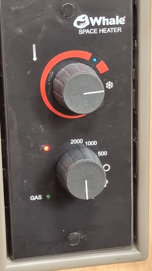

When I turn the whale space heater to cold it runs for about 5 seconds and turns off, then gives 4 red flashes. (Ignore knob in wrong direction - see Problem 2.)
4 red flashes ahould be aomething blocking the exhaust pipe. I can't see anything (unless this it the wrong pipe).

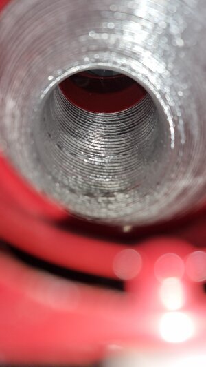

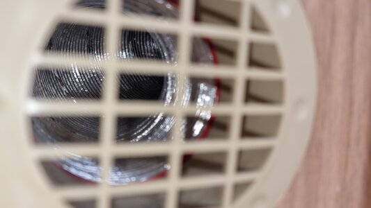

This is the adjacent inlet/outlet:

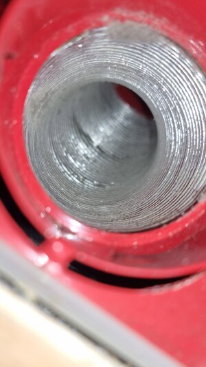

Looking behind the panelling:
I can't see any obvious outlet on the outside of the caravan and everything else seems to happen under the floor below the above red panel.

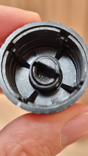

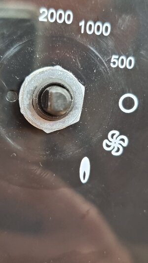

The knob is in the wrong direction. I'm not sure how to change it back.
Any help with these two would be greatly appreciated!
The pipes you are looking at are the ducting that heats your van. The exhaust or flu is under the van directly below the heater.

Just googled ‘Whale heater control replacement knob’ and I think you will find a direct replacement although if you find a generic one that fits it will be rather cheaper! Try searching ‘control knob’ to see if you can find a suitable one for a few pence!
Jan 19, 2002
1,515
429
If the lower control is not lining up with the notation on the surround it should be possible to loosen the nut, gently twist and retighten in the correct alignment. If in doubt make sure the 12v and mains is OFF then remove the screw cover caps and undo the retaining screws so you can see the connections while straightening up - or maybe your van allows you access from the back via the overhead locker?

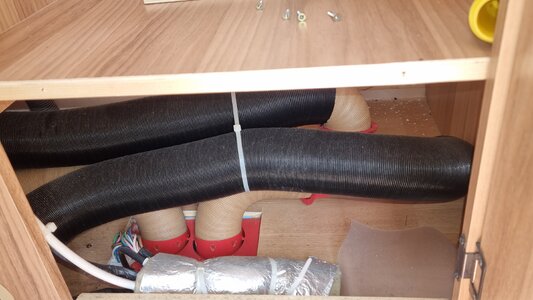

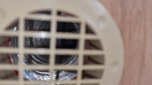

I've done some digging around inside. I've not checked the full length of the internal tubes as they are 2 inches wide and are clear at the internal opening (see opening post) and at the point they go under the floor, see here:
And:
So it looks clear on the inside - although I'm not sure about how to get into the main heater box below the floor.

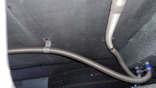

Looking outside, (thanks @Jcloughie) there seem to be two 1 inch wide pipes:
I thought one might be blocked but it was just cob webs. I stuck and old coat hanger down both tubes and the first seemed clear. The second the hanger got stuck on something, but it could have just been a bend. Tested again, still 4 red flashes.
It seems like I might be able to take the bottom tubes off, so I'll have a go at that. They are about 3 and 5 feet long, so I might need to take them inside and flush them with water.
