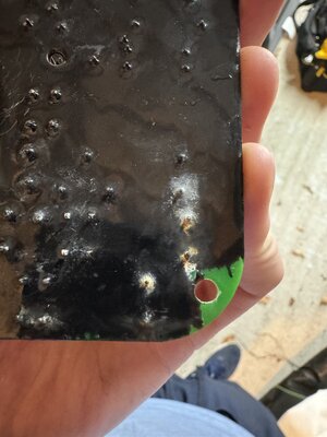

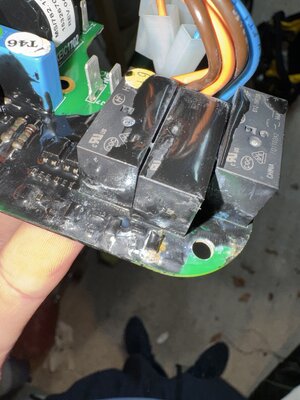

I have ordered a new drain valve and element to see if this cures the issue but have also found a few dry joints/blow marks on the main PCB (see attached photos) which may need replaced also. Could the issue be that the control board is faulty?

Unfortunately the pictures you have supplied are to blurred to really tell if its got poor solder joints, but I do wonder if some of the PCB has been flooded as part seems to discoloured.

My initial thoughts were that the board had suffered some sort of flooding.
