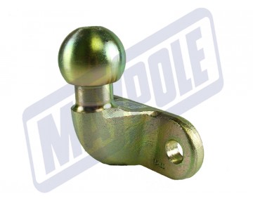

Yes folks the hitch wasn't suited to the AlKo hitch as the Hitch throat was not correct. . Someone will have a piccy..
Note the different throat sizes and how the actual ball is further away from the tow bar bolt holes.

Don't panic. Witter tow bars and associated tow balls are fine as long as the ball is Al-ko style. See my pics. Once hitched and clicked into place does the pop out indicator indicator on the top of the hitch directly above the tow ball area show green?
The safest test for adequate safe hitching is to do as you have, ie wind the jockey wheel down thus lifting the rear of the car. If you are still uncertain ask a tow bar specialist or mobile caravan engineer to check for you.

Thank you dustydog.
Mine must be the black Alko one in your picture.
The pop up button on the front shows just a little bit of green but the indicator by the small handle still shows red which makes me think the hitch isnt seated and locked correctly.
