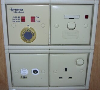

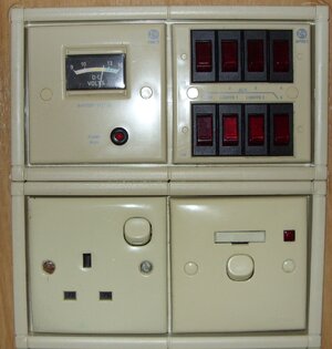

Hello, we have recently acquired an Elddis XL Plus Hurricane that has a
Carver Cascade Rapide GE
GB127900 1999
water heater
The problem is that none of the controls that are grouped together look like the expected control with the On/Off switch and 3 indicator lamps.
I suspect one of the fused outlets is for the emersion heater supply and the Truma Ultraheat was for a ducted heater that is no longer present.
We have looked everywhere but no luck.
Can anyone help?

Probably 2nd row 2nd fused spare, possibly 3amp or 5amp fuse.Ive got instructions for your water heater(Gas Electric) that's what the GE is for if you are curious
19,278
4,473
One of the fused spur switches might control the mains electric element of the Carver Cascade Rapide, and the gas side of the Cascade might be fused through one of the fuses in the bank of 8, but which relates to which is not clear. It is also certain the original Carver control switch is not present, so a previous owner has changed things.
If you got the caravan from a dealer they should resolve any problems, but if you got it from a private sale, perhaps a telephone call to the owner might throw some light on the matter.

It came from a person best described as a dealer posing as a private seller, so I don't suppose they know much about it's history or even care. For instance we where given a Whale Watermaster Pump (stock picture below) but it did not fit because the housing was for a Truma Carver Crystal 3 that was I have been told only made for a short time.
We have since replaced the Inlet with a nice new Truma Carver Crystal 2 made by Filtapac.
Regarding the water heater I have pdf's of the Installation manual and users instructions.
I have noticed that the cable connection to the back of the burner unit is clear and rectangular and not a 7 pin DIN, I don't know if that makes it a Henry, which uses a different control panel, but still the three indicators.
I have had a quick attempt to follow the control cable, but it becomes difficult, mixed in with a lot of others under the floor behind the nearside wheel below the the switch panel, pictured previously.
The hunt goes on.
