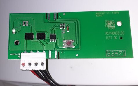

P petepete Jun 29, 2025 1 0 10 Jun 29, 2025 #1 Which way does the wiring block go on the the circuit board on the thetford toilet control panel

I IanB1485 Apr 23, 2024 645 516 1,135 Jun 29, 2025 #3 Thats the thetford C250 toilet board , as you can just see the red wire is a the LHS , and the flush switch centre Attachments Thetford toilet C250 pcb-003.jpg 91.7 KB · Views: 11

M Martin_E Jun 6, 2006 1,034 253 19,435 Jul 2, 2025 #4 The flush plug should go on the rhs. To test it see if you have 12v+ on the red and the first black wire. When the pump plug is connected check the voltage on the blue/brown wires when the switch is pressed
