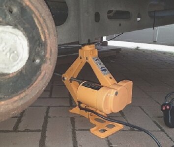

These should be fitted back to back on either side of the chassis rails and will be a permanent fixture. The bolt holes are already punched into the two chassis rails a metre or so behind the axle. The Alko lifting jack fits into the opening on the end of the bracket, and when the jack is lifted, it takes up the chassis with it.
I have them fitted on my van, however, instead of using an Alko jack, I use an electric jack.

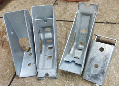

Nearly always with a twin axle van the rear wheels block access to the Alko jacking point especially with motor movers fitted.
Jaydugs photo shows the unreinforced type of jacking point , that had a tendency to bend whilst lifting the van.
When selecting jacking brackets it is important to select the correct type for the weight of the caravan. I would suspect that where the bending of the bracket has occurred, the wrong bracket has been fitted in the first place. As for brackets being described as ‘original design’, the same design shown in my picture is still in production – but only for use on caravans with a wheel load of 800 kg. If the correct bracket is fitted, it does the job as it’s supposed to. Mine have been in use for more than 12 years – but then my caravan is only 1200Kgs.

Wether the design shown is still in production , it still shows the "Original" design which has been updated/ uprated for heavier caravans, especially for the ones shown in Saxo' photographs.

Alko caravan chassis with pre-punched holes for the fitting of jacking brackets were introduced in 1991. A glance at Alko’s current website shows that the 800 kg jacking bracket, first introduced in the 1990s is still in production looking exactly the same as when it was first designed.
But then 25 to 30 years ago, caravans were much lighter. Within my own Avondale’s range dated from the 2000’s, an 8mtr shipping length, 6-berth, twin axle Argente caravan had an MTPLM of only 1600Kgs so it could be fitted with an Alko jacking bracket.
It’s only in more recent years that Alko has added to the range because the MTPLM’s of caravans have increased, so now in addition to the 800Kgs bracket, there is a 1000Kgs bracket.
It is an addition to the range. Not an updated/modified/upgraded version of a failed previous design. Providing an Alko bracket is fitted within its specification and used according to recommendations, it is, and always has been, a reliable means of lifting a caravan.
