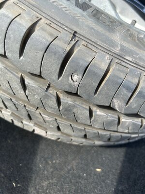

The caravan has just had it's second service, all okay but a nail was found on the edge of the tread (not repairable) and also discovered that despite the caravan being 2 years old the tyres are just over 4 years old..... Rather than just change the damaged one I opted to have both done considering the age of them. The only ones I can get locally are £90.70 each. Ouch.
Best to be safe though. I would have thought that that was repairable. Just nails in the wall that weren’t.
Apparently the maximum damage diameter allowable is 6mm, that one is nearly 10mm and only the middle 3/4 of the tread area. It's an odd one though as the nail is only around 2mm diameter but it's "punched" out a bigger diameter. I'm a bit picky about tyres hence getting them both replaced. Just need to let my wallet go and have a lie down now.....

No way that hole is 6mm in diameter, if it was then all the air would leak out around the 2mm nail!

Look again, it's not a 6mm hole but more of a punched-inwards section surrounding the nail between 8 and 10mm diameter. In nearly 40 years of driving I've never seen one like it before. I'll give blackcircles a try, thanks

My local depot who fit my Blackcircles tyres use a gauge to “measure” the hole. If the gauge can be pushed in then the tyre cannot be repaired, as further reaming is then used to prepare the hole for the repair plug, which is then vulcanised.

That nail looks like it might have had a round head that has worn the away at the damage.
