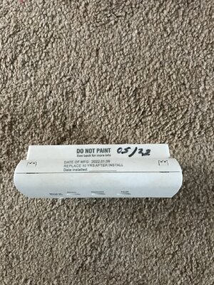

Apparently how is now out of date and needs to be changed? I keep forgetting to check it every time we check on the caravan. We need a similar configuration for the back plate to avoid making more holes. I think it is a Kidde smoke alarm.
19,913
5,227
The Kiddie CO alarm I had was a life of ten years or earlier if it failed it’s regular test, ie before every trip.The photo shows the wrong Kiddie, now being replaced and the smoke alarm below.
I was also under the impression that ours also had a 10 year warranty? It was the AWS tech that said it needed replacing.
19,913
5,227
He may be right. Some I have seen have shorter life spans , 5,6 or 7 years. The quoted lifespans are model specific not a simple generic life span.
