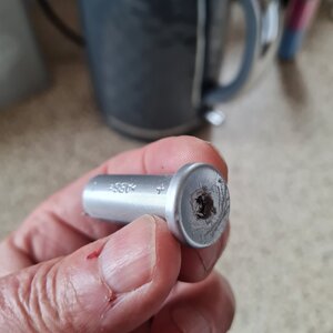

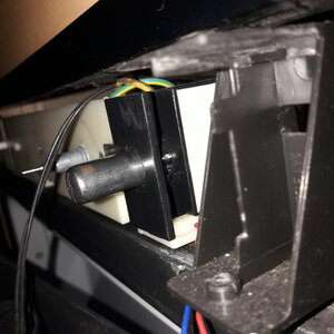

Here’s the photos just now of my battery powered igniter.
Bailey via their spares dept specifically sell the new battery powered igniter system for the RML 8550 as do a number of other suppliers.
I will stand corrected on one point . The grey button attached to the metal canister is removed by turning clockwise and replaced and fixed by turning 90degs anti-clockwise once the ears have entered the little slots.

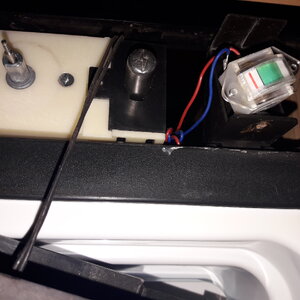

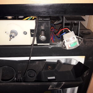

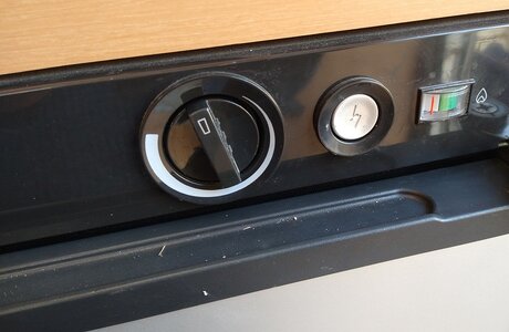

In your video that to me looks like a piezo ignitor , rather than the battery ignitor which has a larger button and is recessed slightly. It requires a bit of force to work( you appear to be just pushing gently which is for the battery type) you have to push it against a spring. The taps on the manifold are all on as the lever is in line with the outlets.

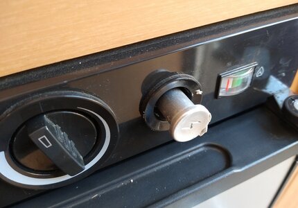

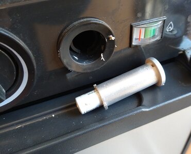

I still think you don't have the battery ignitor , I have just replaced a battery in a dometic 5310 which has a battery ignitor and taken these pictures showing the a, the knob in situ, the knob half out and c the battery inside removed the knob . I think you have the piezo igniter.

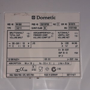

What’s the product number of fridge it will probably be something like 0092………
That will sort out what you have for certain
I see what looks like the side of an AAA battery in a gap. See previous video and side view photo below.
Rating plate says:
MOD. NO. RM 8550
PROD. NO. 00921087009
photo of rating plate below.
