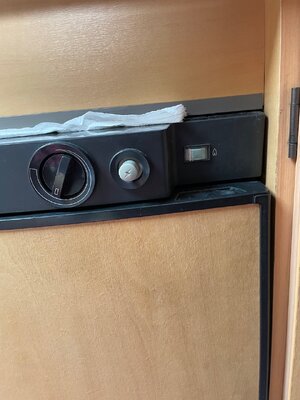

Hi all,
We've recently bought a 2010 Bailey Pegasus 554 caravan which I think has a Dometic RML8550 230v 12v LPG Gas Caravan Fridge. We don't have mains power in the current location, so for the first time, I'm trying to run the fridge on gas, but when I try to press the igniter button (grey button to left of gauge) it doesn't move. I followed the instructions in the manual, which was to hold the temperature control in first. I think the button has a small battery inside it, and I know how to remove it, but doing so also requires the igniter to be pushed in which isn't happening.
Has anyone else seen or heard of such a problem?
Any ideas what causes it and how to fix it or a more appropriate place to get advice?
Here's a still photo of the fridge and here's a video showing the problem. and here are the manuals. (Note: I didn't bother holding the temperature control dial in for the video, but I have the same problem when I do.)
Thanks.
Terry

Hi Tel7
Welcome.
I have the same fridge and have experienced the same problem.
The battery corroded and gets jammed inside the housing.
Looking at your video the push button appears stuck in the pushed in position.
With some gentle persuasion you should be able to twist the button anti clockwise and pull it out.
You will then see a meta tube which holds the battery. That will be seized. Use some penetrating fluid overnight and remove the battery AAA.

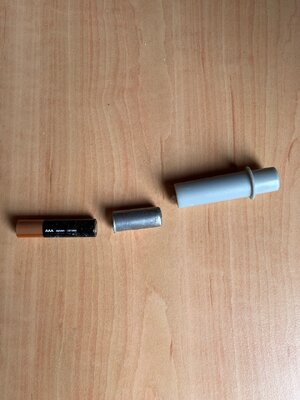

I have exactly the same model as the OP. The RML 8550 . No one has mentioned anything else.
Here’s the photos just now of my battery powered igniter.
Bailey via their spares dept specifically sell the new battery powered igniter system for the RML 8550 as do a number of other suppliers.
I will stand corrected on one point . The grey button attached to the metal canister is removed by turning clockwise and replaced and fixed by turning 90degs anti-clockwise once the ears have entered the little slots.
Even the OP mentions a battery😉

The OP was very specific Hutch and described exactly my model. Hence my photos .
Terry
Open the door wide and look underneath the control panel. You will two small Phillips screws.
1. Turn both control knobs to the off position then pull them off their shaft. If they tight you met need to use pliers for grip. You can use some tape to protect the knob surface
2. Remove the two small screws
3. Carefully pull the entire black top panel towards you. The galvanometer will drop out but two black wires will remain connected.
5 Gently let the panel hang. You will now see the entire ignition unit including the button.
6 Twist clockwise 90 degs and it should pull out.
Please let us know how you get on

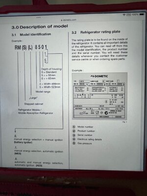

On the basis that Tel7 is correct with his description of the fridges model number RML8550 as defined in the instruction manual It has a manual piezo ignitor , not a battery operated electronic igniter. Thus it wont have a battery.
Thanks John.
I'm confused.
The piezo igniters don't need or have a battery, right?

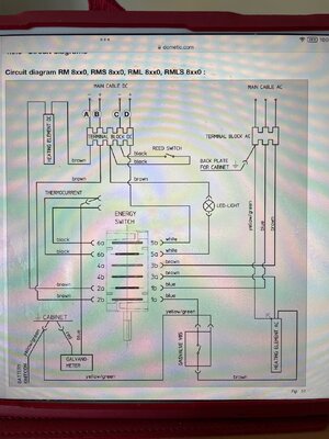

Page 11 Operation Manual shows the RML 8550 has a Piezo Ignition.
Then Page 12 has a diagram that says "RMx 8xx0 / Battery igniter" on the right. Doesn't that mean the RML 8550 should have a battery igniter?
24,062
8,449
Thanks John.
I'm confused.

If you recall I did say the manual in my opinion was confusing. And here is great example of this;
First of all I will refer you to page 10 of the Operation Manual you have identified, where it breaks down how model number defines the product you have. The last figure in the part defines how the energy source and the ignition is managed:-
0= manual energy selection + manual ignition
(battery igniter)
1=manual energy selection, automatic ignition(MES)
5=automatic and manual energy selection, automatic ignition (AES)
But in the table on page 11 the last but one column clearly states RML8550
"Ignition Piezo"
A piezo ignition is a purely a mechanical device that requires the user to physically push a button which compresses a spring and at the end of the buttons travel, the spring is release which causes a small mass to strike a piezoelectric crystal. when struck these crystals generate an electric charge which can reach several thousand volts enough to create a spark hot enough to ignite a gas air mixture. No Batteries are needed.
However I do admit I haven't worked on one of these fridges for a long time, as it was not one of our products, and having re read the manual there is an alternative interpretation of the information on page 10.
The description of the final part number digit refers to "
manual ignition (battery igniter) " I assumed this to mean it requires manual intervention every time the flame needs to be ignited, but it does not define the process used. The fact the last two columns in table on page 11 differentiates the types of Ignition as "Piezo and Automat(ic)" to me was indicative that the manual option was a "piezo" And checking for availability of spares a Piezo ignitor is identified in the Dometic parts list.
But it has occurred to me there are two types of electronic ignitors used by other manufacturers There are devices that produce a series of sparks whenever power is applied. If this was the type used in the fridge it would require the user to press a button every time they wanted to light the flame. Some cookers use this type of electronic igniter. The sparks are only produced when you press the button, so it could be called a "manual ignitor" In the case of a fridge using this type of ignition, the gas would continue to burn on a pilot burner so the next time the fridge needs to be chilled the flame does not need to be reignited.
But there are also more advanced fridges that where the fridge fully automatically selects the energy source and when to turn the gas on or off, which it does to control the temperature, so each time these fridges need to chill using gas, the control system has to turn on the gas, and start the ignitor. But it also needs to recognise when the flame has been established so it can stop the ignitor from constantly ticking. These are technically called ignitor's as they have the means to detect when a flame is present. These are used where full cycle gas control systems are used.
Dometic in their table of page 11 Specify Piezo, Perhaps it is a misprint - lost in translation, but that is what I based my previous assertions on. It is a misprint I'm sorry, I'm not responsible for their documentation. But as an engineer I took the information that was available.
It is therefore possible the manually operated fridge might have an electronic spark generation system fitted that is controlled by a manual switch that requires a battery.

Bailey have confirmed they Do NOT modify Dometic fridges nor in Law are they allowed to as gas is involved.
The attached photos explain the type,of ignitions used , as also described by the Prof above . My photos are from the correct year.
Thus I maintain all my previous posts were honestly ,and correctly technically stated.
I promise I didn’t make up the photos of my battery powered ignition button 😇
