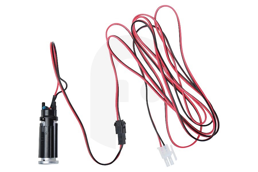

I think you would have to buy the whole thing. I found this on the web
I think you will find that’s the wrong one, the correct one should be as my previous link as sourced by production number, and it matches the one in the OP’s pictures 🤔
And the extension tube is available https://www.ebay.co.uk/itm/19630433...e=1&gbraid=0AAAAADihhqXqjmGpzgjqKafC_FUyzdDTv as an example cheaper may be available

Martin_E I was replying to borderbilly not the OP. Borderbilly showed the a picture of the battery type drilled out to get at the battery. I agree with you that the OP has the piezo ignitor which either he not pushing hard enough or its jammed

The op has the one I have posted 🤔
Boarrdernilly has the one you posted
