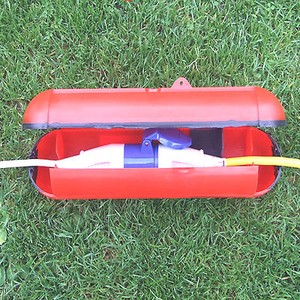

It is very important to understand the difference bet weather proof and waterproof connections..Below is an example on a water proof container for the plug and socket.
Loads of similar types available on line.
SAFEBOX WEATHER PROOF for 16A MAINS PLUG COUPLER ADAPTER CARAVAN MOTORHOME BOAT

Similar colour to the Sainsbury bags that I used to duct tape up 😂

TBH like OC, a brightly coloured Tesco or Sainsbury plastic bag works fine in the worst of weathers so not bother with its technicalities. LOL!

I’d be surprised if the example of a waterproof enclosure as per in #41 is no where near waterproof enough going by how it looks to run the hook up through.

Good post Prof. The IP are I think more for submersible applications. The example I pictured says it is waterproof but no IP grading. But better than nothing or maybe not as good as the good old carrier bag😜

If you look at the chart I posted you will see the IP grading is not just about submerging, it covers a range of situations and not all of them are liquids. Low numbers low protection high numbers better protection.
As for the effectiveness of the item pictured, I couldn't tell how water proof its is, so it's entirely possible that plastic carrier bag might be better;).
Just a note when I have had to use cables outside that are jointed, I usually raise the connector up and cover it so the cables either side have to rise to the connector, which reduces or stops water or other debris from running down the outside of the to the cable glands.
