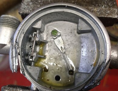

One thing to note is always keep the regulator above the bottle no matter what size it is , Attached is photo of the insides of a regulator fitted a mere 18 months ago completely inundated with oil causing it to fail, It was below the output of a refillable bottle. Advised client to fit an inline filter and move regulator higher up. All gas bottles should have a form of restraint to stop them falling over. I see so many that don't-accident waiting to happen, except it's not an accident ( unforeseen event) it's highly likely to happen to some poor idiot
