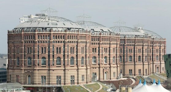

Could always return to storage units like these in Vienna, since decommissioned, although most might prefer hydrogen stored elsewhere and underground.
25,923
9,579
Interesting thought on storage: love the Vienna ones.
Fine for LNG but Hydrogen?
It does go with a big pop.
In the 1980s I was involved with a Canadian advocate of Hydrogen, Dr Geoff Ballard, who set up Ballard Power Systems and his prime interest was in using hydrogen for transport power using fuel cells. Alternatively my main interest was the safe storage of hydrogen. I recall attending a demonstration where an incendiary bullet was fired in to a hydrogen storage vessel designed for a bus application. All we got was a brief puff of flame. Same when another round was shot into the container. This was because the hydrogen was stored in a metal hydride. Our application of interest was hydrogen generated at pressures up to 3000psi required to be stored prior to disposal, in parallel carbon dioxide had to be captured for disposal, whilst nitrogen partial pressure had to be maintained. To add further complexity carbon monoxide and freons had to be managed too. We certainly did not underestimate the potential of hydrogen to spoil your day.
