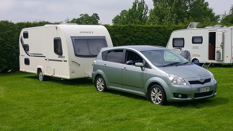

I was the same as you only last year I was limited to 3500kg as I passed my test 3 days after they changed the ruling , it didn't seem nothing then but after learning everything in the last 5 year when starting to caravan I was gutted because it interferes with all my weights and what I was allowed to tow but last year I done my heavy goods which upped my limit anyway but like people say if you do the test it'll be a lot better , but still getting a car and outfit can be done within your limits .
We enjoyed 3 years off beginners caravanning with this outfit but all under 35oo !
