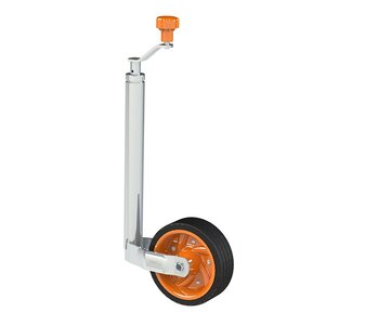

I quite fancy one of the Kartt systems I'm assuming mine is a 48m would it be ok to use the original Alko clamp?

The Karrt Ultimate is a huge improvement over the standard one, and is a straight swap.

The Karrt premium is a huge improvement over the standard one, and is a straight swap.
In what way is it a huge improvement over the standard one as surely a jockey wheel is a jockey wheel? :unsure:
Jun 16, 2010
383
168
18,735
Subjective, but for me
The wheel is wider and taller, so runs better over grass and gravel. Also runs over my dropped kerb more easily, the Alko one would get hung up on it.
The quality of construction is better, the handle can't wind down due to vibration and the handle itself is much more comfortable to use.
Initially, i only swapped as the Al-ko one provided by Swift was too short to get the caravan level without using blocks !
15,678
4,898
Thanks. The rubber on our wheel has seen better days, but is still operational as the rim is metal and not plastic. Does the Kartt have a metal rim with rubber tyre?
Never had an issue with this jockey assembly unwinding, but had it on a previous caravan. Is there a reason why it can't wind down while in transit?
Can we assume that the unit splits in tow like the ALKO and that no modification is required to the jockey wheel shaft clamp?
Sorry for all the questions, but good to get answers from someone that is using one. (y):D

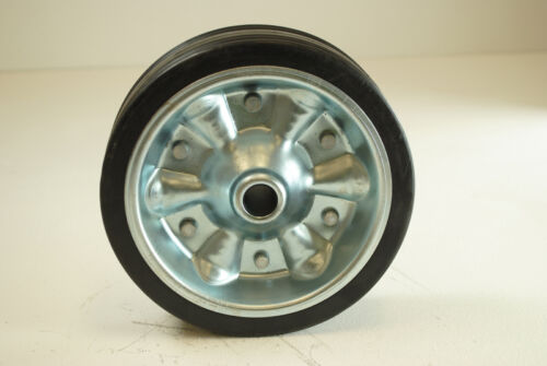

I expect that Pamplona is aware that you can purchase replacement wheels. I have just done this as the track surface was almost worn away - and to my surprise when I removed it I found one of the 'spokes' in the centre section cracked too. The original was likely to be BPW and although I measured carefully to replicate as close as possible I did need a couple of shims to ensure the new sat centrally in the fork, along with a new split pin and now ready to roll! One of this ilk:
OIP.9NceS1OOLNHxvbKnc19x-QHaFj
15,678
4,898
This is our current jockey wheel and I cannot find a direct replacement for it as it has the metal rim. Most seem to have a plastic rim which cna crack after a few uses. Although it is an ALKO chassis, the jockey wheel assembly may be a BPW assembly?
24,089
8,461
Not a very good fitment for a caravan with such a high noseload. Probably use the same fitment across all, or many, models.

That's right, it's a metal rim with rubber tyre. It splits in two, just like the Al-ko one does and is a direct replacement (no modification required)
It appears to have a ratchet type mechanism to prevent it unwinding. Not something I came across on my last few units , but my sister in laws jockey wheel did it all the time. In fact, i gave her my old one to try and stop it
Plus, it's bright orange, and who wouldn't want that !
I searched google images and although you would need to check sizes is this the sort of thing you need?

Going back to post #3 I think that the Kartt non slip would be best as we use a lot of CLs and the fact that the wheel itself is a lot wider than the standard ALKO wheel has swayed me so instead of replacing the tyre we will go the whole hog! :D

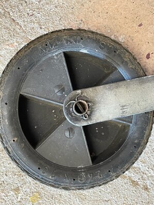

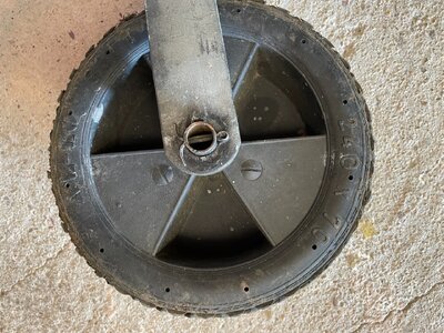

You need to know the OEM SPEC before looking at pictures with no spec!
Here‘s a pic of my Senator oem . It’s big and heavy. Designed by Al-Ko to match their chassis, which in turn is chosen by caravan manufacturers for each model . So mine is 240x70 rigid plastic wheel,quite a wide tread
I‘ve replaced with new recently. Why buy something that may have a lesser spec than your oem? Going better is fine of course!
