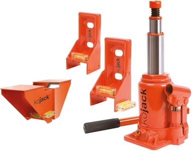

if i buy a set of kojack brackets for the van, do i need to buy there jack? i carry a halfords bottle jack, will that fit/do?

The little brackets which fit onto the trailer have a round bar on them , the Kojack jack has a mating round 'hollow' ( see photo) this allows the two parts to 'lock' together. A 'normal' bottle jack doesn't but has a serrated flat surface , so may slip off the bracket ( particularly if not on the level). your choice

Thanks for that Ian, I thought as much. Being a tight Scot I thought i would get away with just buying the brackets. Better to be safe then sorry. (y)

If you are already carrying a Bottle Jack then just place it under the reinforced bracket where the axle fixes to the chassis.

Here is the Kojack bracket, it is the same as the Alko heavy duty one. One point is that you real need the van to be as close to level by raising the nose on the jockey wheel to get a safe lift.
Which seems to preclude the caravan being on the tow car's hook, which is IMO itself a massive plus re jacking up a caravan "safely", the more so if only jacking with a direct lift jack.
I am firmly a user of the tow car for this and for using it to haul the stricken wheel up on any suitable blocks, ramp etc to get it as level as possible and sometimes to even place the jack correctly.
12,679
4,818
You can still raise the nose with the car attached to the van, if the nose of the van is low , you will not get a safe lift using the Alko or Kojack jack points. I fully agree about raising the flat wheel by using ramps.

Strangely Hutch my 15 year old Kojack brackets are different, triangular compared to my original Al-ko which as you know failed dangerously. The oems were straight brackets that when under load collapsed and bent through 90degs. At the time Kojack brought out their triangular heavy duty brackets which for me have worked safely with no issues.
The following photos are like mine. I can’t find now the originals of the Al-ko failures.
