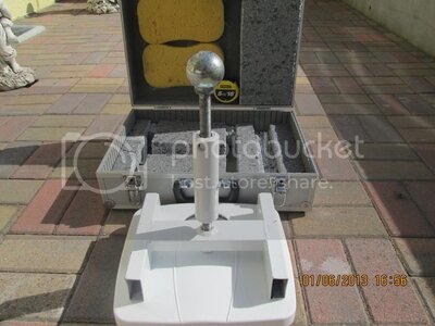

Hi. I want to make my own nose weight guage, and have a sturdy broom handle ready to saw, but how long do I make it?
Many thanks.
25,087
9,079
It depends on how you plan to Mount it. The aim being to measure the noseweight at the hitch height that the caravan will be when hitched to the car towball.

When on the scales the end of my pole is the same height as the tow ball.
Works fine for me and is more accurate than my Milenco bouncy gauge🫣
