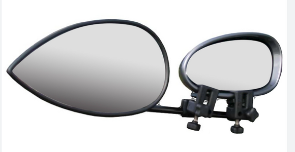

I have a 2017 DS4 which has teardrop shaped rear view mirrors. I have towed caravans for over 50 years and have several types of towing mirrors. Beacause of the shape of the rear view wing mirrors I don't seem to be able to find any that will fit on safely without rubber bungy or cable ties. I was very happy with the three different types I have but cannot seem to find any that will safely stay on without additional strapping.
Anyone have any idea of a brand that will simply fit on this car without issues??
A family member had a similar issue with a SanYong SUV.
She solved it by fixing them on the bottom edge of the housing rather than the more usual top.
Edit - sorry should have said they were Milenco Aero.

.......with Milenco mirrors you will find that you will need V shaped rubber feet for a top of mirror fitting.
These grip curved mirror housings better....they are sold as a kit of 4.

Thanks guys for your advice. I have bought a set of Aero 4 mirrors and tried fitting them. They seem to do what I want. One of the sets of mirrors I already had was the Milenco Falcon with the same mirror head but rubber straps and was the type I had to use cable ties and bungy straps to hold in place. Looks like I have spare mirror heads if needed :)
