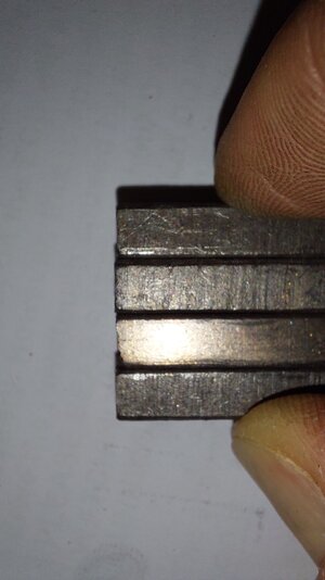

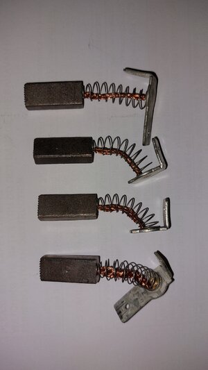

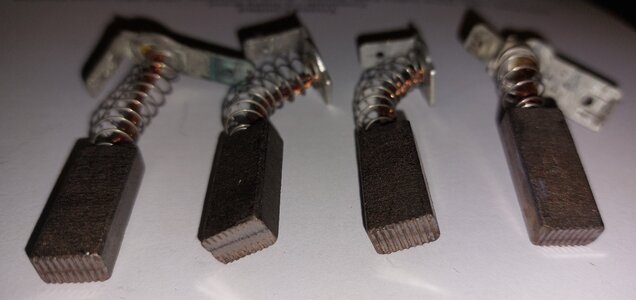

I partially disassembled the movers tonight. All bearings seem good and they are in very good condition generally. There is no sign of water ingress anywhere and plenty of unhardened grease. I think the van can hardly ever have toured after these were fitted, to be honest.
I also pulled the bushes for inspection as suggested. I've attached some pics of one motor's set. The other side were similar. I've cleaned the push connector contact area. Would you bother changing these?

Brushes
It looks to me as though the Brushes have plenty of life left in them.
