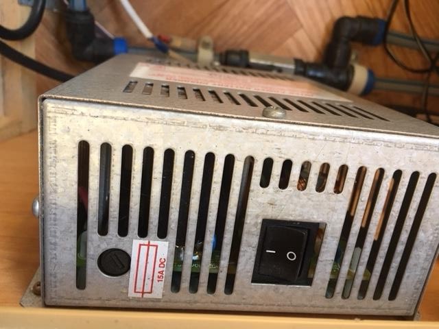

Ive now taken off the battery charger unit, I dont know how to get the fuse out of the box, it looks like you would just turn a screw and it should pop out but im not sure how to access it. ALso How do you attach an image in the post, thanks?
Jun 11, 2018
8
I've just put links to the images of the control panel and the internal battery charger. The control panel has no power apart from the red charger light. The battery changer unit has the black round circle on top, will this be the 15 a fuse in there. If this has gone will none of my system work?? Thanks
Jul 15, 2008
3,857
1,014
..........the round black cover shown bottom left is the 12volt DC output fuse from the power supply/battery charger.
Insert blade screwdriver the same size as slot and unscrew anticlockwise.
If the fuse has blown and replacing it restores the 12 volt DC output......you still need to locate and check the main battery supply fuse ( see previous post ).
The battery will not supply power or receive a charge if this main fuse has blown.
Jun 11, 2018
8
Right, I finally got the fuse out, I'd already tried turning it with a screwdriver, but it was stuck, I had to unscrew the cover and drill the rivets out. Gave the fuse box a little wiggle and it finally popped out. The fuse is dust! So, it might just be this, I'm back at the van tomorrow so I can check for the inline fuse also. Thanks for your help, I'll let people know how it goes. Fingers crossed :)
