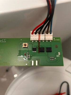

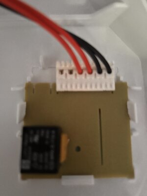

Thank you for your reply, so this would make sense as to why I can’t see a fuse near the casette bay, the main fuse board does as you say combine the toilet on input 5, the fuses light up when they are broken, I did replace it anyway and the fridge is fine so the flush should work etc. there is another random circuit board in the cassette bay (pic attached). I might speak to Thetford and ask for a replacement. Interestingly using a voltage tester on the board on top of the toilet it does show that one of the black cables is not receiving power, everything else is. Stumped!

Thank you John, indeed! I have tested the circuit board inputs with a voltage tester and one of the black inputs is showing no signs of power. I have attached a pic and drawn red line to the one
