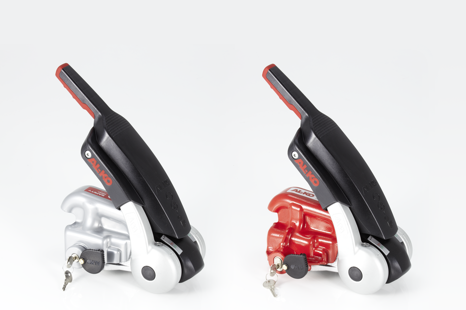

Hi, I've just bought a 2004 Abbey Freestyle, which is in lovely condition. I've not currently got a tow car, so it's stored in my garden and I want to ensure it doesn't get stolen so I've bought and fitted a Stronghold wheel clamp for it. I want to get a tow hitch lock too but don't know which one to get - could anyone tell me which one fits and has a good safety rating?

Welcome to the Forum. I would look at the Alko hitch locks as there are two models I used the conformal one that fits very neatly over the Alko stabiliser head, if your van has one fitted.

Thank-you, I have been looking at them, I'll aim to work out which one will fit best.

As for hitch lock I have a saracen gullwing, easy to use.
I would also recommend as I have done install removable security posts as these serve several purposes, visual deterant, slows down any attempts of theft and also gives some protection to the front locker been broken into.
