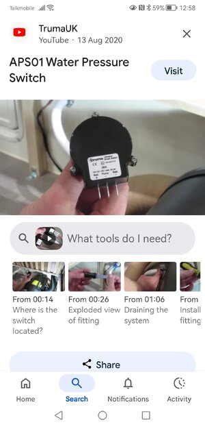

Karlrob Do you mean the old Truma smart pressure switch like the one in the attached photo
