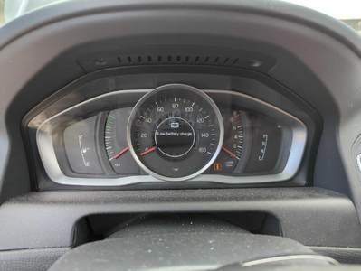

Just had to have a new alternator fitted at 99k miles, and an idler pully which was shot. Total came to just shy of £1500 for parts, servicing, MOT & Labour. Parts were expensive, £580 for just the alternator & belt, but a non-Volvo sourced alternator from EuroCarParts was only £90 cheaper. Buy cheap/Fit twice?
