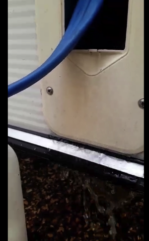

I was away for a while and have just now tried to get the water system to work, using your kind advice. I think the tank in the caravan has filled up, because when I switch the pump on, water is now flowing out of the inlet. But still nothing is coming out of the shower room or kitchen taps. Any ideas anyone? THANKS!

Water is flowing out of the Inlet???? That sounds wrong, can be more specific, perhaps more pictures?

The water is coming from the bottom of the 'trapdoor'. It only comes out when I turn the shower room tap anti-clockwise (which I was informed is the direction for 'ON'. It wasn't doing this b efore, I think it might be only since the tank in the caravan is full?

18,869
4,103
Water should not be flowing out of the inlet. That means something is wrong. You have a Carver Crystal Mk1, and it looks like its original with the caravan and makes it 32 years old. The plastic has aged and become more brittle. The whole unit in the wall will need to be replaced, unfortunately that model is no longer available and you will need to find an alternative.

Thanks for your advice Prof. What am I looking for exactly, I mean what is the unit called so I can look up some options?
18,869
4,103
If you check on ebay for a "Carver Crystal mk1 housing" you may find the necessary parts to replace what you presently have. you will also find some of the filters the unit uses.
