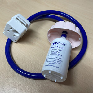

Thats it and not a bad price as some are advertised at £61. But even so I think it is unnecessary expense and complication which the caravan industry seems hell bent on doing. For aeons caravaners and motorhomers have used a basic hose connector without filter and are still alive to tell the tale.

The OP has not been supplied with an external pump. He was keen to ensure that if he went off grid then he could use his aquaroll so he bought an external Whale pump. What he bought from CMHC was the incorrect item, as being unfamiliar with his new caravan he made an honest mistake. My Swift had an internal pump, all others were external....so much quieter.

My 15 year old Bailey has a new internal Whale pump which via this simple piece of kit draws the water into the caravan from the aquaroll. Truma systems are different . Clive has explained the two types already. The OP does not need an external pump, nor will it work on his system and the caravan connection is not powered. The filter on the end serves as a weight to keep the pipe submerged.

There are three totally different water systems. Hard to tell which one the OP has. Looking at his own pics it can’t be the Whale, must be the Truma? But there is a third system with the Alde Flow system which incorporates an on board cold water tank, on board pump but does not require a second pump in the aquaroll .
The OP did give the impression in their first post that they already had the caravan which is why I was confused. Looking at #17 it does seem as if the connection is a Truma connection but difficult to see under the plastic. I am not sure why the OP does not speak with the supplier and ask the question as the supplier will be able to give them the correct answer instead of us all guessing?

As I found out he hasn’t taken delivery of the caravan yet! I agree looking at the photo in the bag the connection is definitely a Truma. However what is not clear is the system a full blown Alde Flow or a Truma hybrid with an on board cold water tank.The OP will no doubt make sure the Dealer gives the full run down on the water system and let us know.
