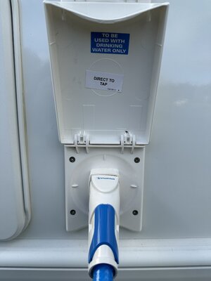

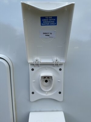

We are at a fully serviced pitch and noticed something odd, when looking at someone else’s caravan.
We have our hose connected to the cold water tap (which has the regulator), which then leads to the Truma intake connection, not to our on board storage tank.
Our neighbour has the water going from the tap to the Aquaroll, which then fills up using the ball valve kit, then the hose from the Aquaroll to their intake connection.
Why would they not just have the same supply method as us?

Its largely a matter of personal choice, but there have been a few instances of the water line pressure regulator failing and putting full mains water pressure into the caravans pipework. Mains water pressure can easily reach 6 Bar with extra pulses the occur when others on the same water main tune their taps off, This level of pressure will radically exceed the maximum pressure that caravan appliance's are designed to withstand. Appliance's and fitting may leak or be permanently damaged. Whilst that is bad enough, the resulting leaks can also damage the wooden structure of the caravan.
I stress the incidence of the regulator failure is low, but the disruption and cost it can cause is high.
The use of the water carrier with a float valve avoids the above possibility as if the float valve fails all that happens is the water carrier overflows but becasue its outside the caravan the caravan is protected.
Another reason to consider the float valve system is in some cases the caravan sites water main may suffer with highly variable flow rates becasue of other caravans demanding water. Having the water carrier buffers variations in supply flow and pressure.
And a third reason is that the mains water line pressure regulators often have poorer flow rates into the caravan than the caravans own submersible pump. If you need a good constant flow for showers, the sub pump may well be a better bet.

Here we go again! Neither one is better than the other as they both can lead to flooding of the caravan if an internal pipe comes apart. Just a matter of personal choice. We have been using direct mains for several years with no issue.

I have a direct connection fitted as standard on our Lunar Clubman - I've used it a couple of times but the pressure regulator seems to slow the flow too much so now I just use the submersible pump from the water barrel which gives much better flow - I don't bother with a valve for the barrel, just use the direct connection hose to top the barrel up each morning on a serviced pitch.

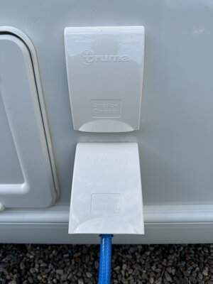

Hi Hutch,
All we had was 2 hoses under the seat beside the door.
First short hose was for the outdoor connection to a shower head
Second long hose was what we’re using just now at the fully serviced pitch, it connects from the tap to the Truma inlet.

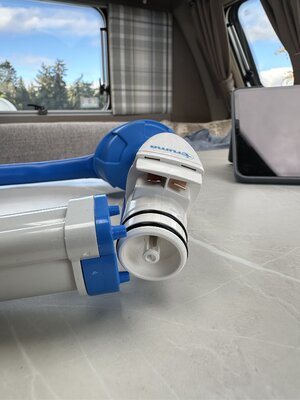

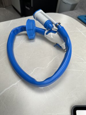

Oh sorry forgot, this one also which is for the Aquaroll which they had in the sink on pick up and used to fill the tank for a demo.
This is the Truma one which is useless at it kinks, which is why we purchase the Whale one
Which has the metal pins
I have both the Truma pump and also the Whale pump with the Truma connector to the caravan.
I have fitted the Truma pump pipe with a 22 mm insulation cover which not only keeps it straighter, but insulates it for winter use.
It is interesting to see you have both the fitting for an electrical pump and also just a water inlet to the van.
