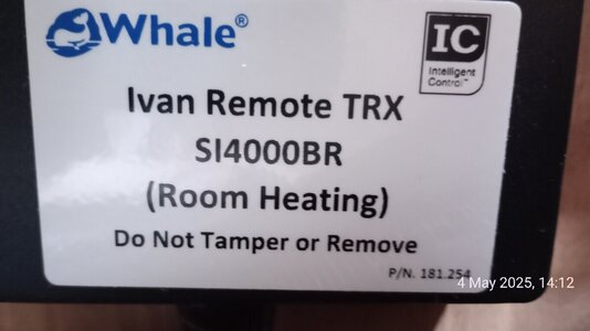

Hi
just found a picture of my space heater remote control box. This is the one that Whale told me to open up and reset. So ignore the "Do not tamper or remove" sign
