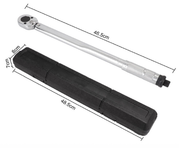

Hi all. About to go on my second ever trip now, and just realised that not only have i not checked the torque on the wheel nuts, I don't have the tools to do so. As the 'van is stored away from home and I can't check the locking wheel nut drive for size, quick few questions :-
( before I buy i torque wrench )
1. Is the drive size generic for modern wheels ( 2015Bailey pursuit) i.e. 1/2" or 3 /8" more likely ?
2. Anyone use the bright yellow plastic 'wheel but indicators ' you see on trucks and busses ? Seem like a good idea for just a few bucks.

For the amount of torque you will want a torque wrench with a ½" drive, a ⅜ one won't be man enough. As for socket size probably 17 or 19mm

Normally a half-inch drive with a 17 or 19mm socket (if memory serves me right). A torque wrench or a manual torque reader will be needed to do it properly. Suggest you look at You Tube if you are not used to using them.

Bailey generally use WSL wheel bolts that would require the correct adapter, this requires a 19mm socket and is set to 130 NM and 1/2” drive torque wrench
