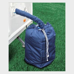

Just about to cut up an old sleeping bag but decided to check on-line sales of bags to help insulate the aquaroll. (We are away over Christmas in the Van and have been for many years visiting family. However, so far no real freezing conditions but suspicious this year we could be caught out!).
At around £18 delivered the on-line bags will save a lot of messing around with sewing sleeping bags and devising a waterproof cover for the whole bag of tricks!
Does anyone have any experience with the on-line insulated covers please? They don't look particularly substantial.
Are they waterproof or do they get soggy and heavy if it rains? (Yes, I know no need to use if raining but could easily be caught out)
Do people take something to stand the aquaroll on - ideally a bit of polystyrene insulation I guess.
At under £20 seems hardly worth the messing around to make our own. And no we don't have an old padded jacket we can use.
Edited to attach example pic.

I have used the green Aqua roll covers, only twice have we really needed them, France in January for a month of snow, and at a site Home Farm , near Ivinghoe Beacon, for a week. They worked very well, I put the grey pipe insulation around the pipe to the van and then the green sleeve all stopped freezing.
They don't seem to get wet, must have some sort of waterproofing, ours are over 12 years old now. They do have a base of the same material, but I have just left them on the ground.
The shower waste froze , and had to use Mrs B's hairdryer to thaw it out, so now I pour a drop of Antifreeze down the waste pipes at night.

It would take a substantial period of sub zero temperatures to freeze the 40+ litres in an aquaroll. The feed pipe from the aquaroll to the inlet point is however vastly more vulnerable to freezing, so thats what I would concentrate on protecting. Either that or just keep about 5 litres of water in the caravan for tea's etc and use the facilities in your relatives house.
We often have family staying, when decamp to the caravan but still shower etc in the house which saves having to worry about water.
