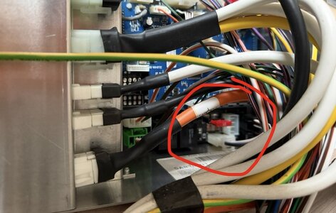

Had a call from the Dealership this evening, someone who was more clued up on the solar panel issue.
Was told to use a multimeter negative (-) on the middle point on the below, and the positive (+) on the next one to the right. If I see 12V on the display then it’s trying to draw current to the battery, if there I see 0V then the fuse under the Sargant Fuse box needs to be located and investigated.
He did mention there was an issue with this a while back due to Swift fitting a less Amp fuse which then needs to be swapped over for a 20 or 25A fuse.

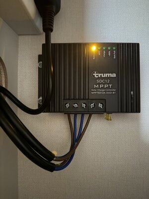

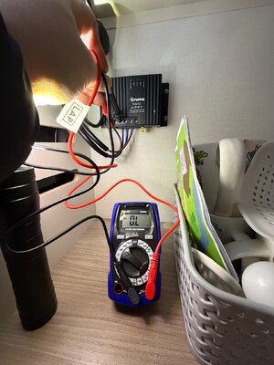

This LINK I believe is for your controller's user manual , if you haven't this to hand.
On page 10 it shows the status LEDs, where having the "Battery low" LED illuminated, as in your photo, could be because the mentioned fuse has blown, therefore well worth checking.
However, if the photo was taken in the dark, then the only power that could illuminate any LEDs has to be coming from the battery ,via a viable fuse, as in the dark it can't come from the panel.
So what that info is telling us depends when you took the photo, in the light of day or at night. Though possibly reflected light off the moon might just throw my logic here.

Sorry forgot to add, the guy at the dealership said to check the (-) and the (+) when it’s dark outside, or cover the solar panel with a carpet if during the day
That photo of the Truma Solar unit was taken at 14:30pm

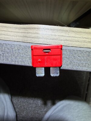

I have went into the back of the Sargent and spotted a RED 10A blade fuse, checked with the multimeter and it bleeped, so that’s all good and has not blown. Presume this is the blade from Panel to Battery

Is there anything I can do at the Solar Unit below?

Looks like the first 2 wires going into the unit are from the Solar Panel, then the next 2 are the feed to the battery

The two left hand connections on the Truma SDC12 unit are from the solar panel, furthest left is +ve the next to it's right the -ve.
To take out the input of the solar panel you can remove, either, I would take out the wire feeding into the +ve, the furthest LEFT

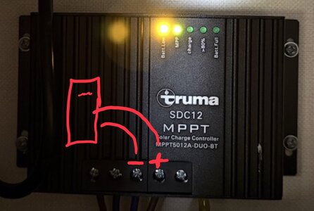

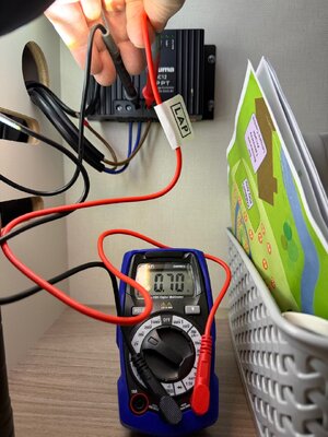

With the solar panel's +ve wire out, as a further test measure the voltage of that +ve disconnected wire* to the 2nd from left [solar -ve] screw on the solar controller. This will give us the present open circuit solar panel's voltage. Looking for above 19 volts, but let us see what if anything it is.
* measuring the loose wire's end, to the fixed -ve connection.
This ok?

There is an issue somewhere as it should be the battery's voltage, in your case 12.55, not only 0.7 volts.
You need to hunt for a blown feed fuse or missed set switch. I can't help on what switches you might have to look at, don't know your kit.

Better looking now; I see you are on the "right" ports, those with the battery's feeds.
You should be seeing the battery's voltage. so something is wrong

So with the supply from the Solar Panel feed out, measuring the Voltage from the (-) second wire to the (+) I pulled out, we should be seeing a Voltage from the panel current. Because there is no Voltage something must be wrong…
I could not find any other fuses under the Sargent like what everyone said, only the Red 10A
This is a bit confusing

Remember the battery is not installed, it’s still sitting at home
Okay, I had not hoisted that all important aspect in.
So you seeing 0.7 volts means something is giving power albeit very little.
Possibly its from the solar panel, but your view of my panel test is showing that is way down.

Agreed, it is confusing, but is clearly showing the solar panel's output is way down of what I would expect in any modest amount of light.
Without the battery in your first test is not providing me with any constructive info.
Edit: all I can suggest is you repeat both these tests when the battery is back in place, and there is a bit more sunlight, or reflected sunlight as there is here today. That said I still think your solar panel or its connections has an issue, it should be showing much more voltage even if capable of generating near zero current.

Just gone and checked a 30Watt panel's open circuit voltage in very poor indoor lighting and that's at 12.45Volts.
So I am confident in what I said, your 2nd test looking at voltage from the panel does mean there is a panel or its connect issue.
With a defective solar charging system your flattened battery is understandable, that might easily and hopefully be the extent of your problem.

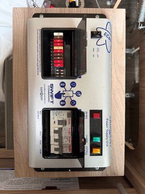

Just out of curiosity, would this be the box which is from the Solar Panel to the Battery fuse, which was connected to side of the Sargent main Fuse box?
Looks like a plethora of screws to get into this cage though…
