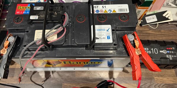

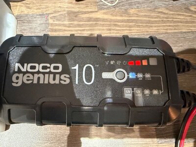

I’ve now moved the battery charging to the garage!
Bit wary of it in the kitchen when something could happen.. :oops:

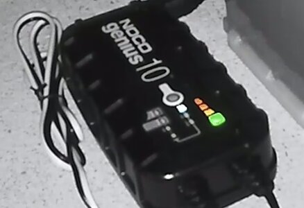

Ok woke up this morning and the Noco is at solid green light.
Just out of curiosity, when I disconnect the charger from the battery, there won’t be any loss of power while it sits in the garage?
Was thinking to leave it in there till I’m able to find the fault at the caravan, which we can’t get to due to snow at the moment.
Need to check if it’s the fuse from the panels to the battery, as mentioned earlier

I used to put mine on charge about once a month, but with a good smart charger you can leave it connected 24/7 as it goes into maintenance mode. Given your history with the battery I’d check its voltage using a meter in a week as recommended by Border Billy. If it’s fully recovered it shouldn’t have dropped by much at all compared to todays reading.

Given the history both the known and particularly here the unknown I would do a blend of Bill's & Clive's suggestions.
To check if it has developed an internal interplate drain, I would give it a couple of weeks off charge to see if it is dropping too much. Then you know its either on borrowed time or not. At least on one mode of battery failure.
Then as you have a quality smart charger, simply put it back on charge and over storage leave it like that.
Just a slight reservation, I would bring it in out of the cold and briefly put it back on charge before starting the off charge test; the present cold can throw things a bit, if your garage is anywhere near as cold as ours.
There is no issue leaving it on charge in the garage.
The 2 Amp unit would have been a bit more suitably sized for the storage use.
